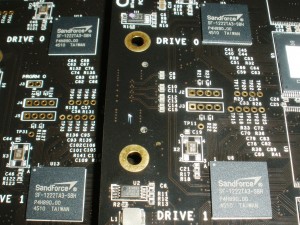

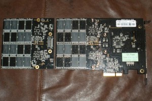

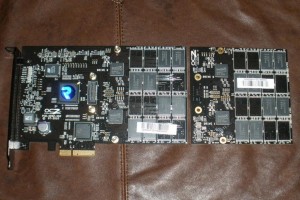

Unlike the RevoDrive which consists of a single circuit board (PCB), the Rev x2 has two board that are considered to be a mother/daughter relationship. Each board has 2 x SandForce SF-1200 processors and each side of each board contains 8 x Intel multi-level cell 4GB 32nm NAND flash memory chips (29F32G08AAMDB) for a total of 128GB of storage. As SandForce processors rely on over provisioning for better performance and a longer lifespan of the drive, the total storage available to the user is reduced to the advertised 100GB.
